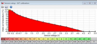

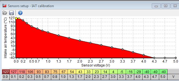

what are your calibration settings for the stock toyota senser , i use the same and the "correct " values would be handy ?
these are my IAT settings
