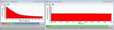

this wiring is ok?
and what is right configuration (in software) ? for my engine?

Wiring is right please use the following cable diameters:
Pin1 min 1,5mm²
Pin2 min 1,5mm²
Pin3 min 0,75mm²
Pin4 min 2,5mm²
And use the following config:
