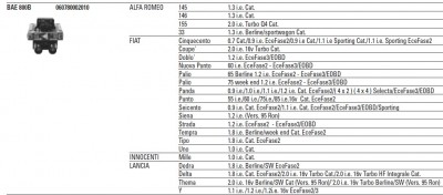

maybe is worth to try 060780002010 this are FIAT passive coil works with EMU perfect and they are quite compact size, provide good spark energy and they are cheep also (with 3ms dwell time at 12V gives you around 9A on output)

thanks for great news :-)
they work without any igniter only on Emu?
On Emu i must change to "coils without amplifier" , right?

Post by Wuniek » Mon Jul 20, 2015 2:03 pm
MichaZ wrote:thanks for great news :-)
yes exactly and check it double because setting it as active coil will result of quick charge and over dwell if you don`t change it quick is big chance to damage ECU ( but service at Ecumaster is very quick:) )
