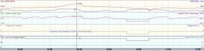

Welshman wrote:this has happened a couple of times and seems random but usually when idling it will just shut off , checking logs i can only see a unexpected missing tooth on primary just before it shuts down , it has happened once while i been driving , is there anywhere i should be looking in particular . ?
perhaps i encounter the same issue, in my case after this engine is stop working i cannot fire it up from run i must turn off ignition and then car starts up without any problem, i was thinking i had problem with my harness or maybe main relay but now im not so sure :

Welshman
Posts:101
Re: Unexpected missing tooth cause ?
Post by Welshman » Wed Jul 22, 2015 3:46 pm
yes switch off then back on and runs fine after .

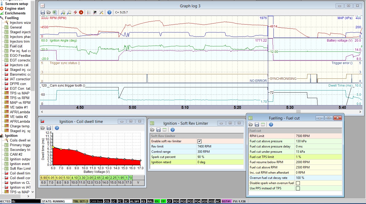

ok I suppose mine problem is different from yours, i recorded new logs today and a movie...
what i see i current logs (dint saw that previous i upgraded today from 135 to 1.136 EXP1) is unexpected voltage drop and only thing i can do in this situation is to "reset" EMU by off/on ignition situation is quite strange because as you see in log battery voltage drops to 0 but all sensor readings working fine
on the movie at 4:09 (4:45 LOG) is first fail you see on log and second one is 4:50 (5:25 LOG)
Post by Jadzwin » Fri Jul 24, 2015 12:34 pm
Look at channel ECU reset. The ECU resets then..
The battery voltage looks exreamly strange. It drops under 5V...
Post by Jadzwin » Fri Jul 24, 2015 12:36 pm
The battery drop is conencted to closed TPS. Are you sure there is no short circuit at 5V when you close the throttle ?
Post by Jadzwin » Fri Jul 24, 2015 2:32 pm
It looks like wiring / TPS problem. Looks like in under some condition TPS makes short circuit on 5V (very low resistance) and the voltage drops under minimal allowable value (6V) what causes ECU reset...
