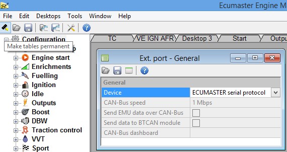

did you set proper protocol in EMU options ?
external port.jpg (26.9KiB)Viewed 9329 times

Can you be more descriptive please?
What protocole do I need to select?
There is a few there in that pic you posted

Ecumaster serial protocol

Selecting under the device drop down menu..
ECUMASTER serial protocol
Have both box ticked for "send EMU data over CAN-Bus" and "send data to BTCAN module"

Where is that menu/setting located? I can't find that anywhere. I am on software 1.134 Exp 1
