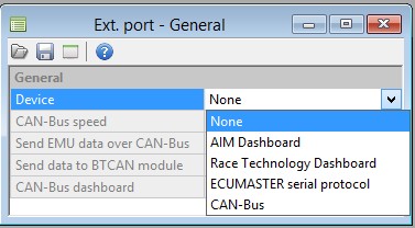

Guys having troubles with my bluetooth app...
Downloaded the app onto android device and I can get it to pair with the ecu but all values are showing zero 0..
What am I doing wrong?

did you set proper protocol in EMU options ?
external port.jpg (26.9KiB)Viewed 9275 times

Can you be more descriptive please?
What protocole do I need to select?
There is a few there in that pic you posted
Re: Bluetooth help..
Posted: Fri Jul 31, 2015 11:25 am
by roquete
Ecumaster serial protocol

So just select that and pair the android tablet to the ECU punch in code 1234 and it should all work?

Selecting under the device drop down menu..
ECUMASTER serial protocol
Have both box ticked for "send EMU data over CAN-Bus" and "send data to BTCAN module"
I can see the emu on my android tablet but when I click on it it reads "Connection failed. EMU NOY FOUND"

Where is that menu/setting located? I can't find that anywhere. I am on software 1.134 Exp 1
