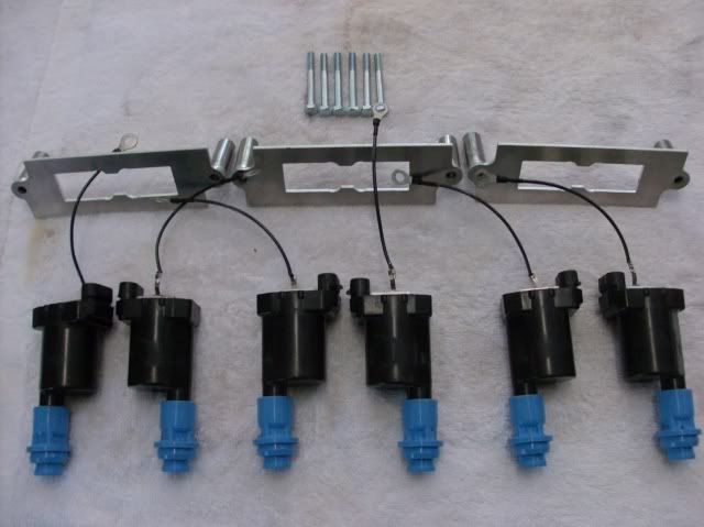

and i am using other Coils from Bosh
https://scontent-vie1-1.xx.fbcdn.net/hp ... 3150_o.jpg

Hey Karel,
can you give us the serial number of your coils maybe?
And from where did you get those nice brackets?
bye
Alex
bye
Alex
Re: 2jz Aristo ignition question
I am making it ... laser cut, and they will be anodysed soon....sulik wrote:Hey Karel,
bye
Alex
