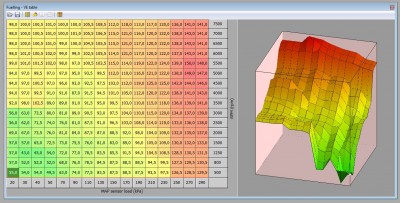

Thank you for looking at it! Could someone else look at it also? If i am to confront the current tuner, i should have several opinions.
Could this map be dangerous to the engine?
Ignition table
VE table
Any other values i should add?

Re: Retrieve data from EMU - need help evaluating map
Post by Karel » Sun Sep 14, 2014 2:55 pm
Yes, it is totaly wrong !
No map should look like Rocky Mountain!
27° IGn at 250kPa and 2500RPM will probably kill your engine if you turbo makes bosst there. And for example 25degree at 4000RPM in vakuum will make your engine run weak like 1.0L 3 cilinder.
Looks like you are copiing values from another map from someone, and you swaped X and Y axis.
VE littel better, but still too rough, you should smooth your map dramaticly!
skogs
Post by PSI-Motor » Sun Sep 14, 2014 7:17 pm
skogs wrote:This map is created by a professional tuner who tuned it on the road... What should i do?
NO! This is not the work of a professional tuner!! Not even a bad tuner! This is the work of a guy with epelepsi that got his hands of a keybord connected to a ecu!
Im taking this very personal due to the fact that he is called a professional tuner! That puts him under the same category as me and it pisses me of :evil:
Post by PSI-Motor » Sun Sep 14, 2014 11:45 pm
Simpel answer. NO engine in The world should have this map end of story.
Post by Jadzwin » Mon Sep 15, 2014 1:18 am
I fully agree with what my predecessors wrote. The tables look terrible.
Post by skogs » Mon Sep 15, 2014 2:30 pm
I talked to the tuner today, and he explained what was going on with the table. It looks bad, but works great. There were some values that were put in simply as a failsafe in areas the car is never supposed to be in. For example vacuum at 6000rpm or high boost at 2000rpm. In the diagonal from vacuum at idle and to full boost at max rpm everything is as it is supposed to be.
We cleaned up the map a bit and took a few runs, no knock and good power. The throttle delay at idle was removed, but the slight starting issue is still there but its not a big problem.
