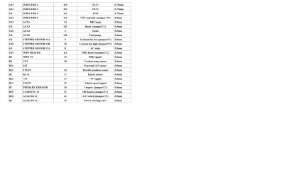

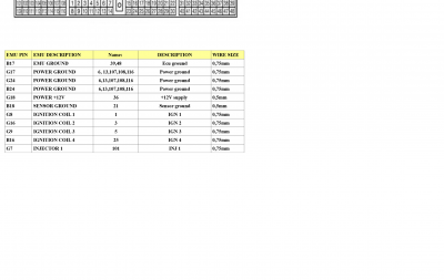

hello i have a s15 sr20 and wired it up according to emu instructions and, i do not have tps, ecu does not know that its cranking, i dont think it has spark or fuel.. basically nothing works .. it wont even prime my fuel pump ( and yes i picked the correct output for it)
i used this diagram to wire everything in.

Post by impeller » Sun Mar 06, 2016 4:22 am
I figured it out.. the picture of the ecu plugs, is the ecu, i thought it was the plugs so all my wires were backwards.. yay, car starts fine now, the manual does not tell you to hook up the ecu relay, once i figured that out and coils got power. it runs , just gotta get it to run smoother though little rough
