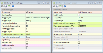

Jan32
Posts:191
Location:NW Germany
Re: Ecu State at Cranking Problem
Post by Jan32 » Fri Mar 11, 2016 2:05 pm
You have to use these settings.
