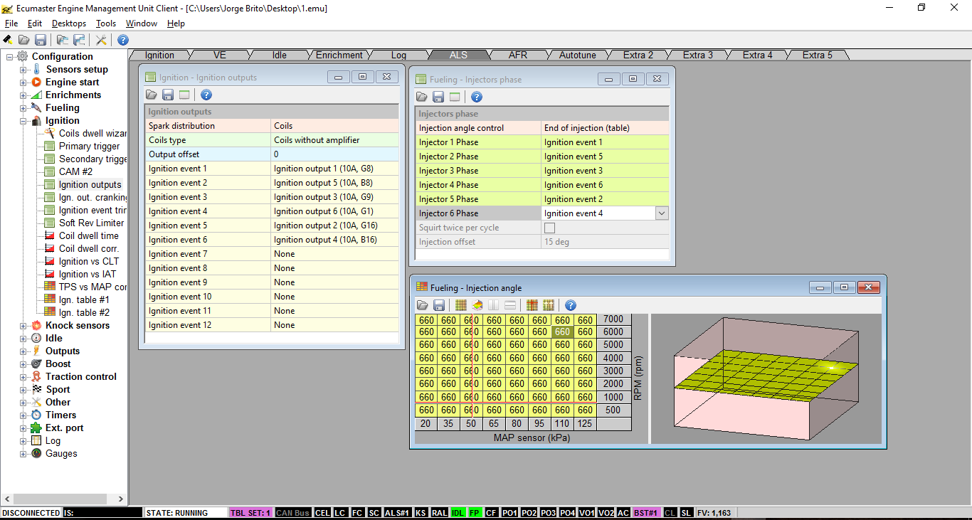

Hi people
My car is a E36 M50B25
Ignition order: 153624
Is this right? i am having trouble with this setup no mater what angle i use at the map... :| :|
