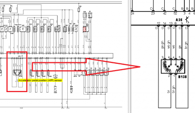

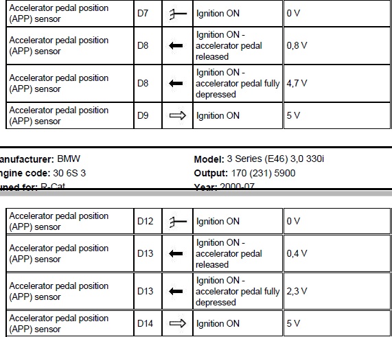

Have a problem wiring my DBW module, actually DBW is not a problem to connect, problem is in accelerator pedal signal to ECU , as i understand i should connect signal wire from accelerator pedal to ECU TPS in pin. But i have two signal wires from accelerator pedal. So how could i do now ? In attachment i added diagram of ecu and accelerator pedal connection and pin descriptions.
e46 DBW
Re: e46 DBW NO pedal response.
I used D8 as TPS in and D7 as sensor ground for pedal position sensor, When i turn ignition on there comes whistle sound from throttle body is that ok ? Also i have VDO 408238424001 throttle body, when i choose it and sellect all inputs in software, when i turn ignirion off and turn it on again, all settings stay the same but throttle body wizard is changing my VDO to BMW 40823842500.PSI-Motor wrote:Use D8
