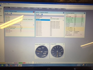

i have a picture that shows turning the engine.

Go in under primary trigger and enable scope, then go to log ----- > scope -----> Crank it and press the arrow "get scope data" whilst cranking.

Problem solved.
The Sekundery trigger type has to stay on "do not use"
Thanks so much for helping.

that will only work in waste spark configuration now
