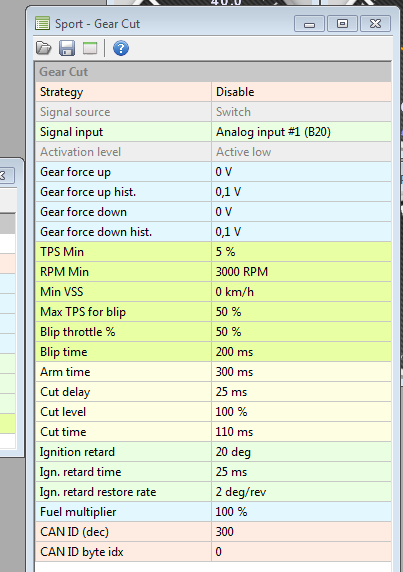

Post by cer » Fri Jul 15, 2016 12:25 pm
Hello again,
this setting i try, and have a limiter at 5000rpm. with the flat shift setting it works

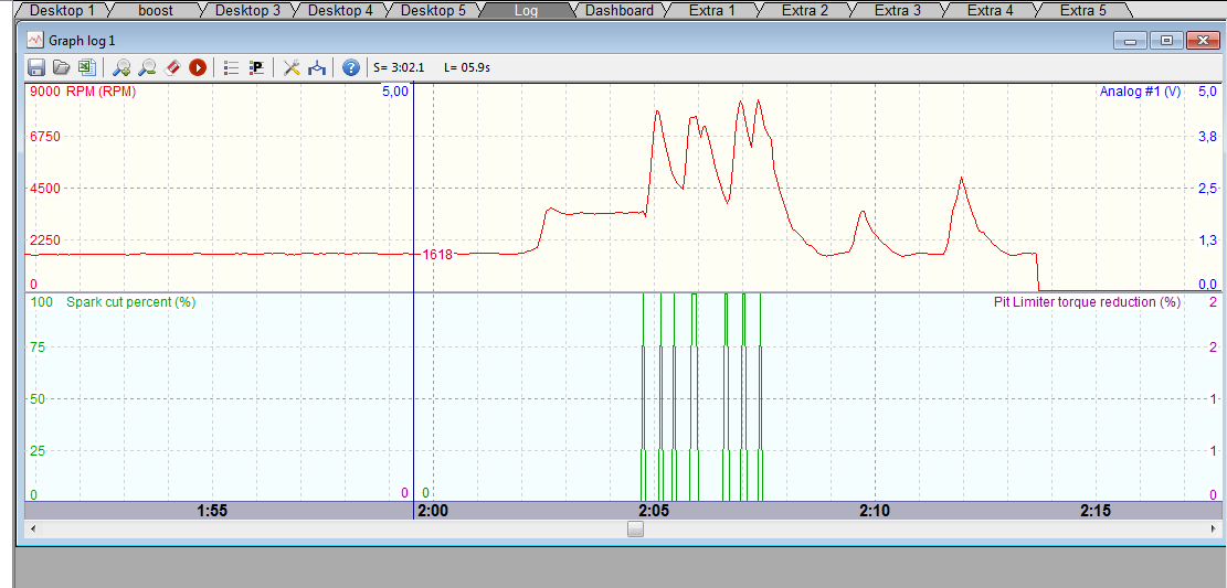

Post by cer » Mon Aug 01, 2016 4:33 pm
her is the log of last race. you can see that the gearcut switch make no signal, but there is a spark cut. what can i do? if i cut the signal cable of the switch then it works without spark cut, but of course you can`t put in the next gear.

Re: gear cut trouble
Post by Jadzwin » Mon Aug 01, 2016 9:35 pm
Please attach here the log and you base calibration
