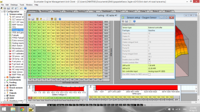

Silas wrote:Hi
I already have a Inno Wideband Controller installed.
Back of the Gauge there are two Datalog Wires (0V-5V) and (1.1V - .1V)
So should i connect the yellow wire of the Innovate (0-5V) direkt to any Analog Input of the EMU?
So i dont Need to connect the lsu4.2 direct to the EMU?
Regards
Patrick
Use yellow wire :)

Any free one. In Oxygen sensor parameters you can select analog input.

Post by ktsirigotakis » Thu Sep 10, 2015 1:14 pm
you have to set also the parameters to work correct see the pic of a friends cars
