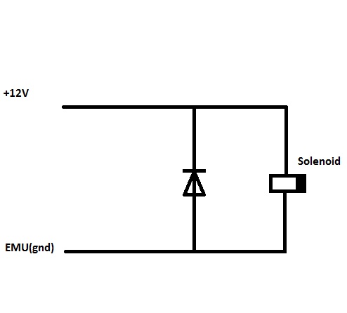

Question is where to connect these 2 wires.
1 wire goes to EMU Output (G4 in my case)
1 wire goes to the 12v fused power supply or to a ground?
I dont want to fry anything so I'd like to be careful.
Thanks in advance.
Kisielisodd wrote:for mac valve it is not necessary to ad flyback diodeEMU will handle it without.
