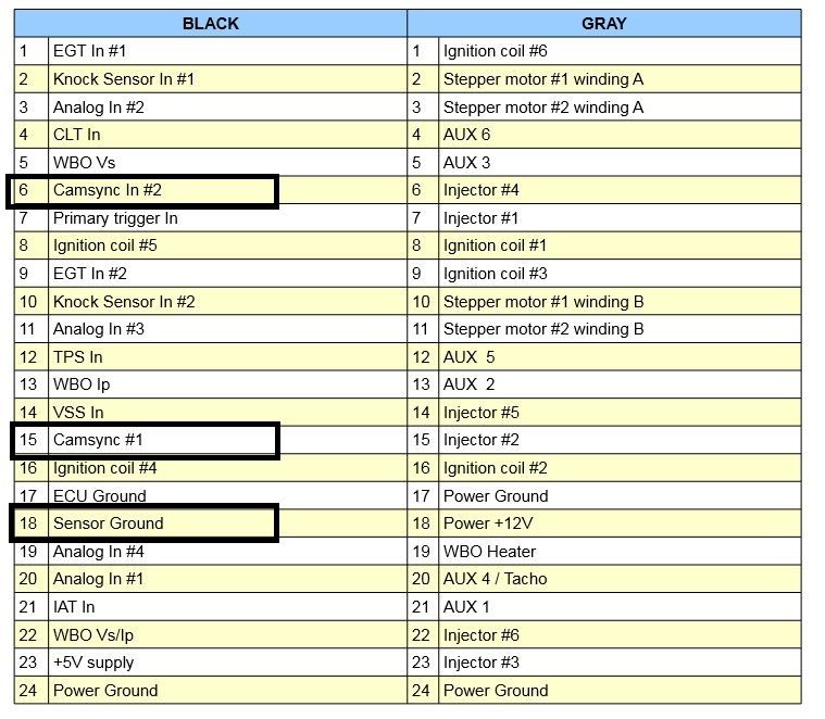

Connected the cam sensor. Original DME is siemens 41.0 and connected pinput 64 (middle pin in connector) to sensor ground in EMU position 18 in black connector and then pinout 65 (pin 1 in connector) to position 15 (cam sync #1).

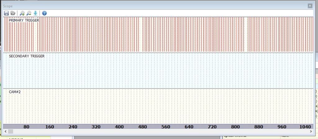

Tried to take scope and nothing.
Moved signal to position 6 (camsync #2) and tried but no scope signal.
i checked all wiring with multimeter to verify connections.

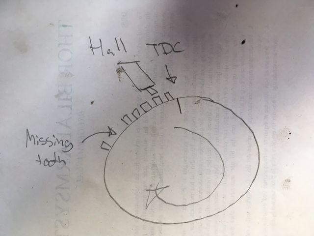

Then I turned cylinder 1 to TDC and made a drawing of how the trigger wheel looks in the hope you can help. And yes it is a lovely drawing

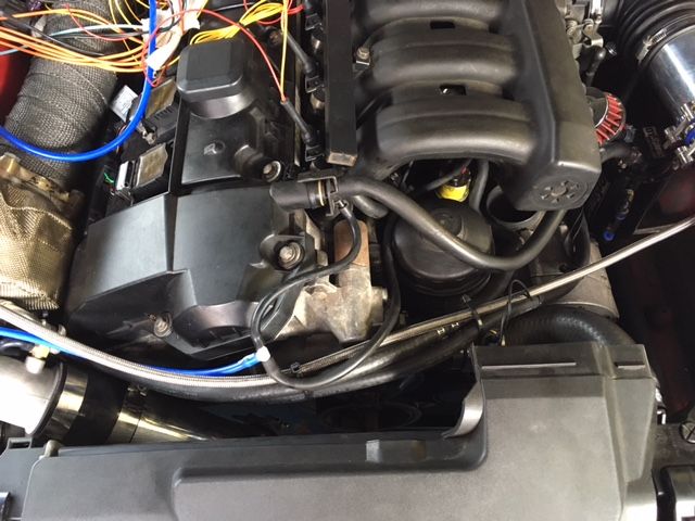

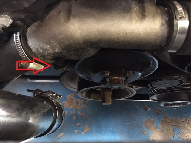

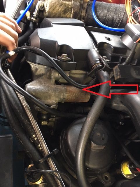

Toke some pictures of the engine so you can see how the sensors are placed.
Crank sensor -Hall.
Cam sensor -? Mismatch. Was told to replace with a hall form obd 1.
Picture of front engine.
I will attach the map and trigger log.

Its a 60-2 wheel.
Can you please explain? I thouht it was 54 teeth after TDC?

Ok i see your still not not getting a signal from the cam sensor and the location of the crank sensor is actually from an m50 engine. So what you have is an m50 block with an m52 head could that be correct??
Using a first trigger tooth of 44 and running the firing order 153624 is the same as running a first trigger tooth of 4 and using firing order 536241 (this is all with a trigger angle of 60) ............ but at this point that does not matter its just a simple case of changing the settings, what we need to achieve is a signal from the cam sensor
The ARROW in your picture is pointing to the VANOS solenoid and the can sensor is tucked in behind that.
There are 3 different sensors: m50 non-vanos which is VR, m50 vanos which is Hall and m52 which is duel VR... do we know this is the cam sensor you have?... since the block is not m52 is it possible the head or cam sensor is also not m52??
It looks like the duel VR m52 requires a sensor voltage to excite the electromagnet you can try to achieve this by connecting as follows
M52 duel VR
Pin 1 - camsync #1 B15 (yellow wire DME pin 65)
Pin 2 - sensor ground B18 (black wire DME pin 64)
Pin 3 - +5v B23 (brown wire DME pin 43)... Might pay to measure the resistance between pin 2&3 if its less than about 1.5 ohms then this will draw too much current from the +5v OP!
Alternatively you can replace the sensor with a Hall effect sensor from an m50tu vanos engine or a single VR sensor from an m50 non vanos engine. Use the colors of the wires above to identify the connection etc.
