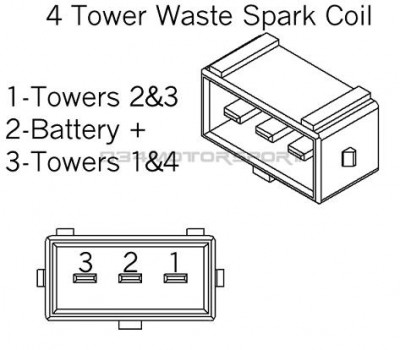

I need an advice to wire a bosch ignition coil for wastedspark setup,the ignition coil is 3 pin
Thank you

you will need to find a matching wiring diagram to find what pin numbers match but 1 pin will have +12v and the other 2 will connect to ignition OP's on the ecu (example IG#1 & IG#2)

i have found the ignition coil pins wiring as you see in this photo,so pin 2 is +12v and pin 1 i wire it to G16 and pin 3 to G8?
Re: Wasted spark wiring
Post by RHD » Sat Aug 13, 2016 5:19 am
yes

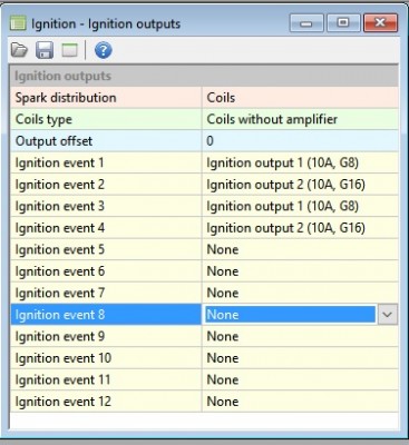

assuming firing order 1342
