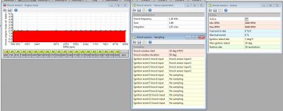

Hey guys,
can u check my KnockSensor settings. KnockSensors are the OEM from the 1.8T.

dontriple wrote:Hey guys,
The engine knock characteristic frequency used to configure the band-pass filter. This characteristic is different for every engine. It can be approximated with the following equation:
Knock frequency (kHz) = 1800/(Pi * D)
Where D is cylinder diameter in millimetres

Hey,
thanks.
Than it should be "" 6,82 "" its a stock 1.8T / Just change this and everything should be OK :) ?
