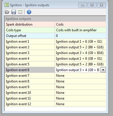

Would the attached ignition output be correct? The firing order on the 2jz is 153624. But Coil #1 is cyl 1-6, Coil#2 is cyl 2-5 and Coil #3 is cyl 3-4.
Re: 2jz NA-T 440cc and COP ignition
Post by RHD » Wed Nov 25, 2015 12:39 pm
I dont know what the difference between GE and GTE triggers are, but the 2jzgte map i have uses falling on both triggers but thats purely dependent on the way its been wired.
It also has first trigger tooth 2 not 3 and the firing order starts at cyl 2 not 1 (ie 241536)
