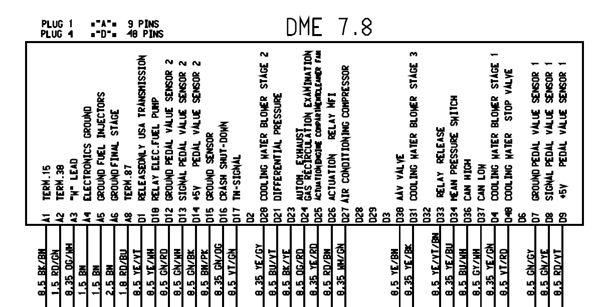

PORSCE 996 TURBO NEED PINOUT DIAGRAMM TO USE ECUMASTER EMU
Post by Jimtsaga1986 » Wed Oct 12, 2016 1:46 pm
PLEASE ANYONE HAVE AN OEM PINOUT DIAGRAM FOR PORSCE 996 TURBO I WANT TO MAKE AN ADAPTOR TO USE ECUMASTER EMU THANKS IN ADVANCE

Post by Karel » Wed Oct 12, 2016 2:09 pm
Jimtsaga1986 wrote:PLEASE ANYONE HAVE AN OEM PINOUT DIAGRAM FOR PORSCE 996 TURBO I WANT TO MAKE AN ADAPTOR TO USE ECUMASTER EMU THANKS IN ADVANCE
Re: PORSCE 996 TURBO NEED PINOUT DIAGRAMM TO USE ECUMASTER E
Post by Karel » Wed Oct 12, 2016 2:10 pm
next one

Post by Jimtsaga1986 » Thu Oct 13, 2016 10:21 pm
thanks a lot for your help i want to see how the 996 turbo will working with the ecumaster emu
