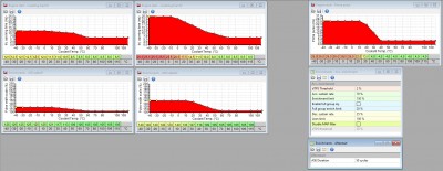

So after cold start, car runs really shitty until coolant is about 30-40 degrees it runs bad, really rich i can smell the gas and see the sod from exhaust if i try and rev it..
Any one know what a good setting would be, to be able to cold start and also run okay after start before 30-40 degrees hot.
#1 Gasoline octane 98
#2 E85
i have flex fuel, so i run a bit mixed, depending on if e85 is available where i do drifting..
Could it be any of these here settings that needs to be changed a bit?
cold start issues after start
Im really new to ECU tuning, but i like to learn these here minor things to be able to fix that my self.

can you attach logfile of cold start (please check if you run lanbda sensor when no rpm, and wait for lambda to heat up before crank your engine)
allso your .emu config file will help a lot to understood your problem.
generaly theese tables take efect only when cranking and then 50 cycles after engine start so on 6cyl its aprox 1sec.
then warmup table takes place, and i think, that there is your issue

If oyu already know your car is running fine at tempratures 40-90°C you also can see what warmup enrichment do you use there.
I see drastical 200% enrichments, so your ecu will inject twice the fuel...... thats bad.
Try with something like in my post and lets see if it will be better, or not. You can always save your oroginal mapping and upload it back if my mod does not help you.

changed warm up tables from 160 to slope down to 30 degrees on both #1-2
works great now
also changed cranking fuel #1 and gave that a bit more fuel..
Now if i get start issue again in future, ill just change prime pulse table, i just need initial boost of gas then it will start and run fine :)
