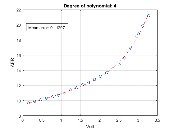

That's pretty cool, I was trying to wrap my head around the coefficients the other night but gave up. Could you help me make a better definition file for zeitronix zt-2? There is one in the software but it seems kinda strange, not supporting the whole range of measurement for starters.

Doable
Posts:27
Joined:Sat Aug 16, 2014 11:27 pm
Re: Problems with IAT probe and AFR signal....
Post by Doable » Thu Aug 18, 2016 11:00 am
Koop wrote:That's pretty cool, I was trying to wrap my head around the coefficients the other night but gave up. Could you help me make a better definition file for zeitronix zt-2? There is one in the software but it seems kinda strange, not supporting the whole range of measurement for starters.
Data on the ZT-2 here.
https://www.dropbox.com/s/4o5oqstj5jn4y ... e.png?dl=0
wideBandO2SensorZeitronix_zt-2.txt
4th order polynomial def
(423Bytes)Downloaded 128 times
Plot
Here you go!
I found that a 4th order polynomial gave the least mean error.
