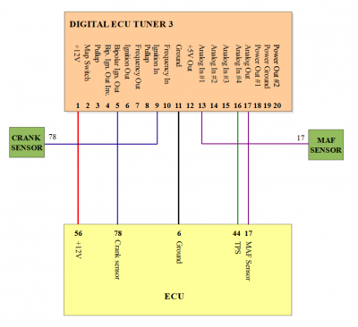

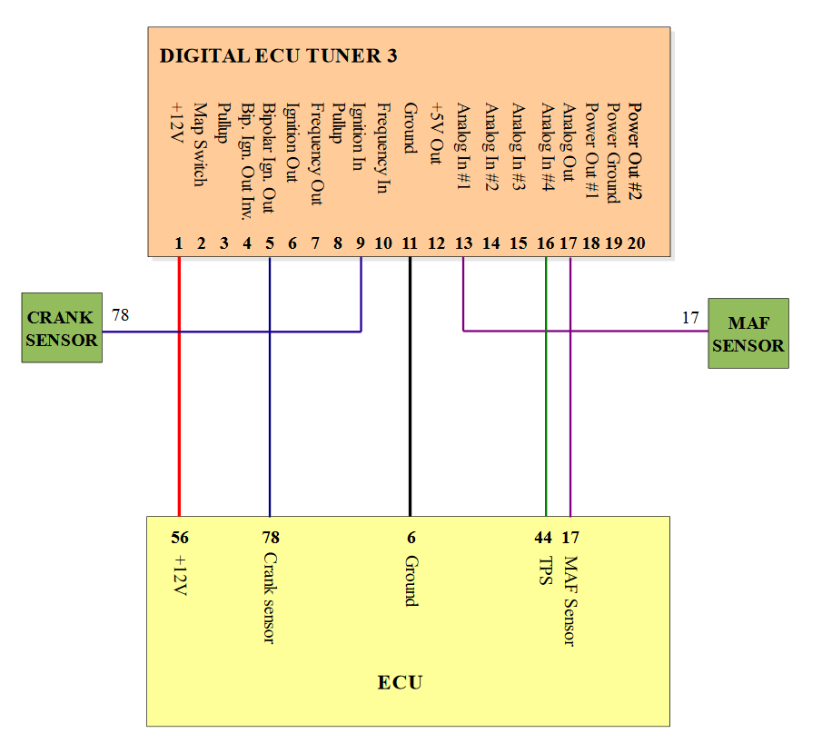

DET3 is connected based on following schematic if matters.
All other is working fine but could not get reading from internal MAP.
