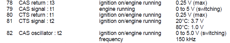

this is the little info i got on the sensor:
but allready tryed the 3 (CAS) wires with or without pullup on multiple ignition configs and cant even scope a signal...
can anyone shed a light on how to do it?
i've also read on some other sites this is a hard sensor to work with since its kind of a completely different sensor from normal, nor VR or Hall but something hybrid...
