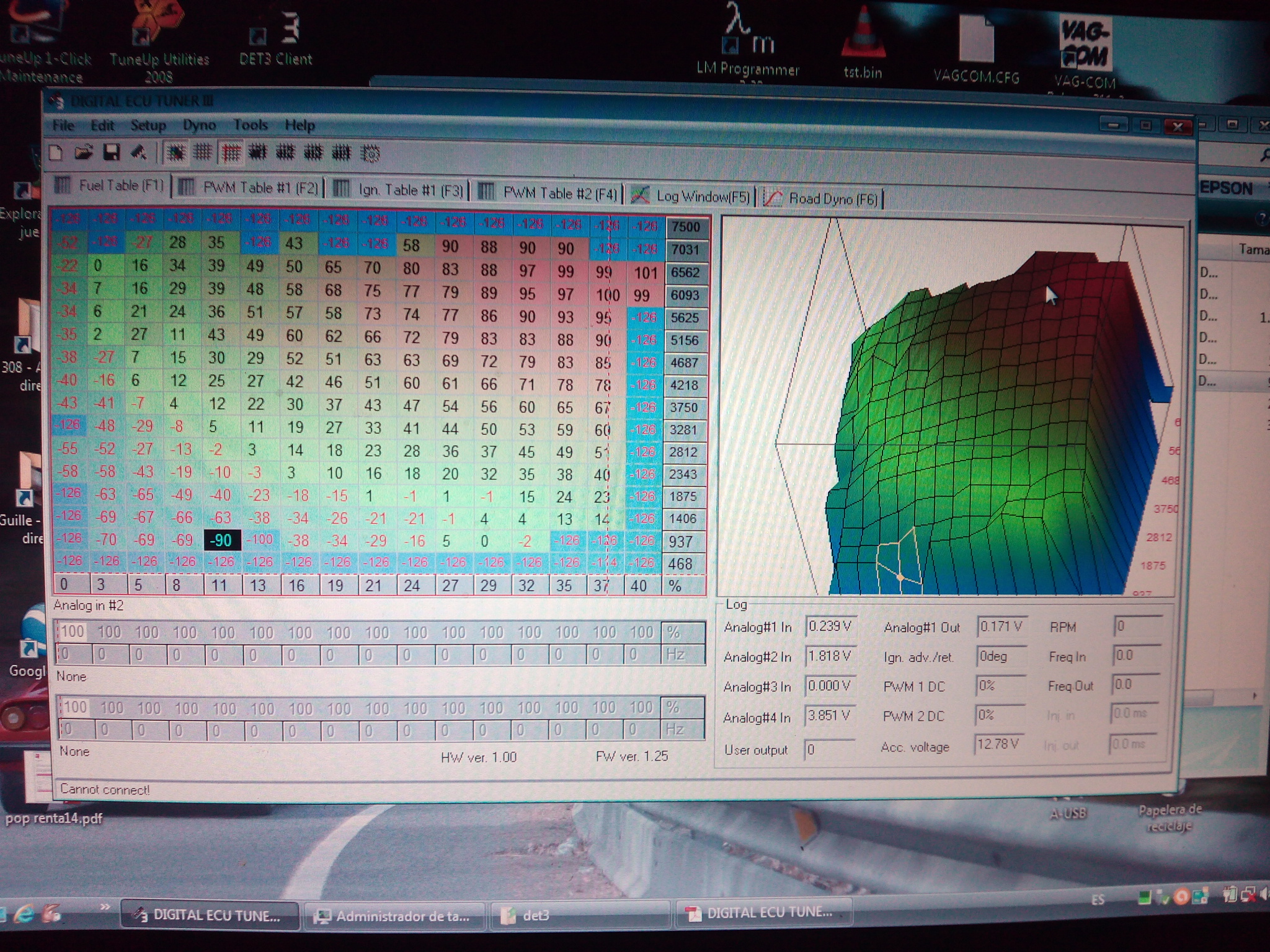

Today I have managed to load my fuel table and get it running (sort of). Conversion works.
Anyway there are 2 issues.
In my scale tab I cannot see the 250kpa Map. 400kpa is there indeed.
Most important, I do not understand the values I am seeing. Sorry for my ignorance, but could anyone explain?
Thanks in advance.

Look at page 15 of attached DET3 user manual.
You can also right click on fuel map and switch display as >> voltage.
For 250 kPa built in MAP use mpx4250.def
