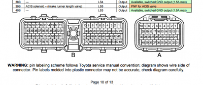

Pin 27B should be your crank sensor. So you'll have to split that.

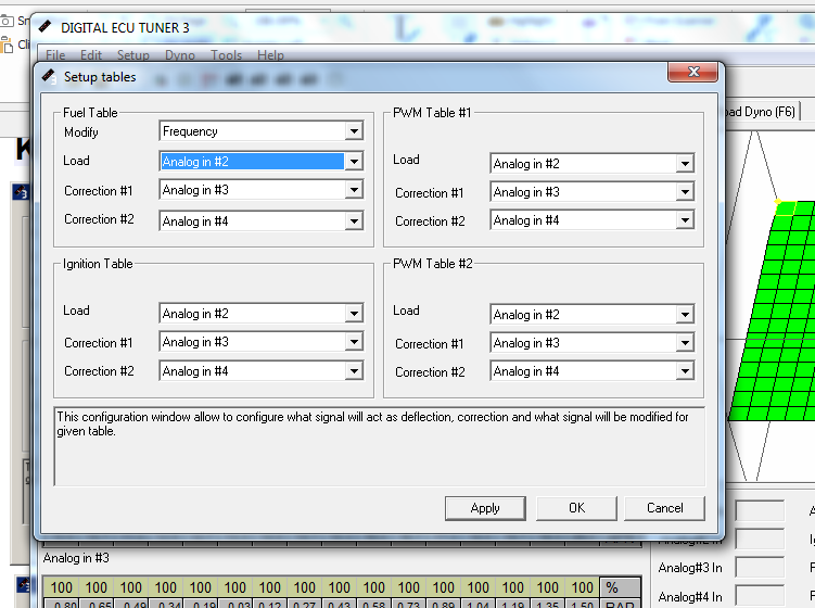

Also I attached what your settings *SHOULD* be

ok ya I did that. on the set up what do I use for the modify and load and corrections.
ihiryu
Posts:237
Re: det3 2jzge-t set up
Post by ihiryu » Fri Feb 12, 2016 1:21 am
Most likely these settings.

where does the pin27b get wired into the det

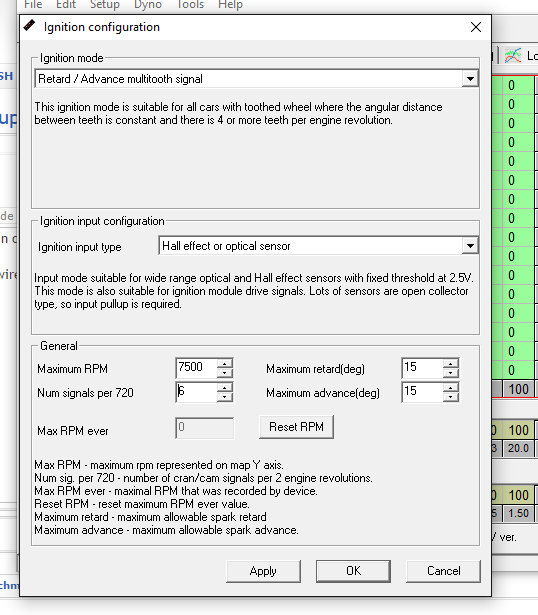

got the car running but the det is seeing double the rpm then the car is showing.

So you got the Crank sensor hooked up?
Change your ignition settings
Num signals per 720, try changing the number down to 3 and try it.

Post by drew2322 » Fri Feb 12, 2016 6:48 pm
I changed it but went higher and that fixed it.
