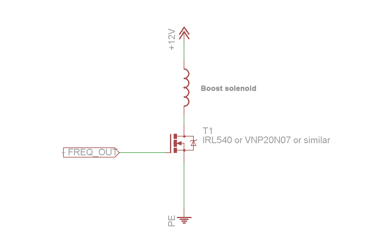

Still reading the manual and I answer myself but have other question, the manual says that in order to use the.boost.controller, i need to conect all the injectors in the first power output (pin20), working on full group (batch fire i think), so if i connect them in bank fire (using the 2 power outputs), I will not.be able to use the.boost controller?
Is that correct? How do you recommend me to connect the injectors to.be able to use the.boost controller?
- ktsirigotakis
- Posts:66
- Joined:Sat Aug 16, 2014 8:39 am
Re: FIT Wiring [ST205]
you can wire the mac valve (boost controller) with the additional transistor so you can wire your injectors in pears. also the benefits of fit mode are much more than piggyback mode, fit mode works like a stand alone ecu but you have the oem ecu to control idle valve end other sensors "secondary staff"
