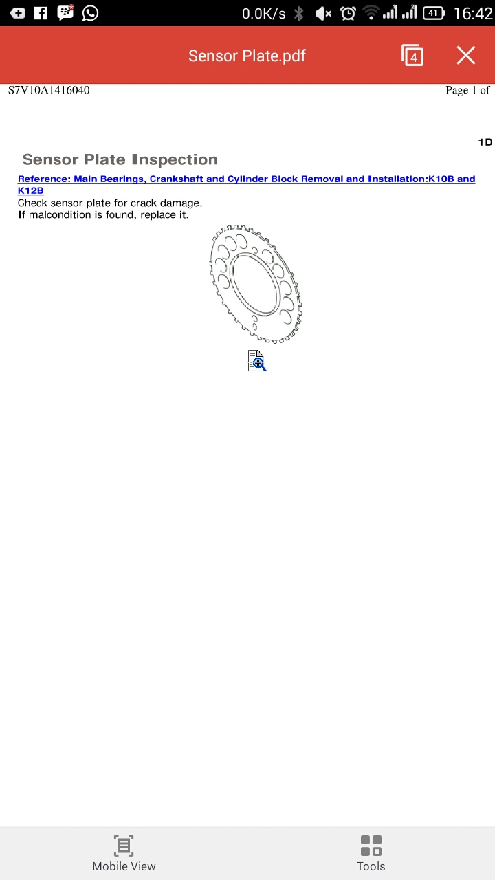

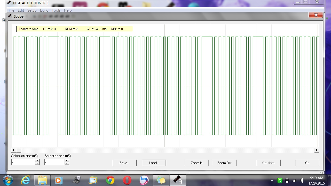

i have problem with ignition retard/advance for my car. the Crank trigger is 36-2-2. and no patern trigger in new software. i asking by email and until now i dont have any new update.
as attach is my collecting data from my car.
and i request new feature for flat shift. thanks before.

36-2-2 trigger scope

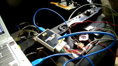

installation in my suzuki splash

Looks like a 12-2 24-2 to me.

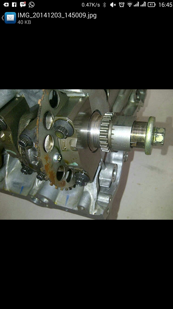

yes. it's like 12-2 and 24-2.
but i don't know how to calculate the trigger plate.
as attach is my trigger plate and how to test the signal in my car.

From Unknown reason 36-2-2 trigger from subaru and similar in swift do not work with det3, so we removed support trigger from list.
Tomorrow we will try to add support of the trigger. We arranged swift with M16A engine and we will work on trigger decoding
**update**
We did test's on car, we have found a mistake, hope we will be able to release new firmware version with 36-2-2-2 support.
Because of technical reasons maximum 9 degree of ignition advance will be possible.
