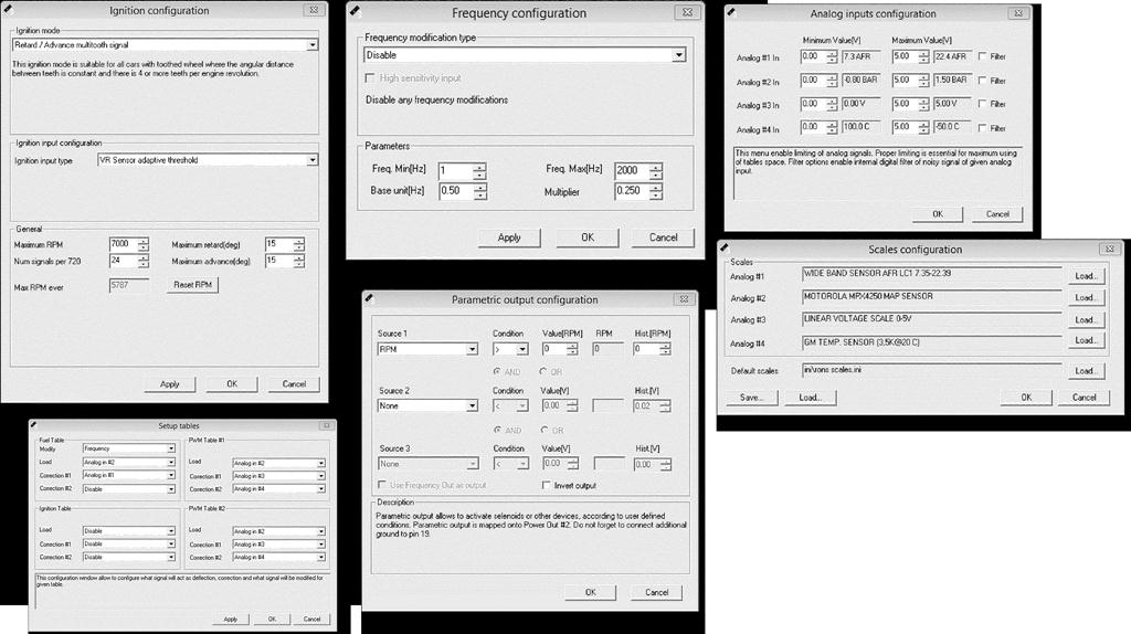

Hi all,
I just got the DET3 wired into my 1UZ-FE. I need some assistance in setting the unit up for my application. I will list some info below and then questions at the end. Help is much appreciated, and I want to help the future community. This little box has so much potential!!!! Here is a basic run down:
Step 1:
- Engine is stock internally
- The internal DET3 MAP sensor will be used
- The stock AFM will be used (to build fuel map and AIT)
- Innovate LC-2 input will be used
- Vortech V2 will be used
- Surface Pro-2 will be used for tuning
Step 2 (comes later on):
- The stock AFM will be removed (resistor will be wired in for stock ECU)
- A GM AIT will be installed in intake
So far I have followed the user manual and found I’m not understanding it in whole. There are many details it does not cover enough, and I totally understand, there are so many applications that have so many variable you can’t possibly give written instructions for every instance.
I attempted to create a fuel map by using the log last night (unfortunately I wasn’t able to save this log). This did something but I just don’t know enough about the system to know if it all worked properly. Since the 2D map values do not update its difficult to tell where the values are on the map... This morning the car was leaning out so far that I removed the AFM and crank signals from the DET3 so I could get the car safely to work. I have four logs from this morning.
I have attached my settings.
Notes:
1. After attempting to review my log I’m noticing the wideband signal is not functioning properly. It shows way rich, when in fact its way lean. <--- Error on my behalf, I went through the Innovate manual. Only one of the signal wires have a 0-5v signal.
2. The power output #2 does not seem to control the fuel pump properly, it’s constantly on. <--- Error on my behalf, I created a "back door" to excite the fuel pump relay, so the DET3 wasnt really controlling it from the beginning.
3. The tables do not update properly when values are changed/updated. <--- Error on my behalf, I realized when I deselected the aix buttons you can see the fuel table values.
4. I’m not able to scroll the log window to view the entire log.
5. Info here on the KS signal http://www.lextreme.com/forums/showthread.php?t=2603
6. I wasn't successful in using a GM AIT, for some reason the DET3 would not recognize the signal and produced no values. I'm still looking into this.
Questions:
1. What are the correct settings to create a fuel map from the stock AFM signal? <--- Was able to figure this out but could not utilize it since I have boost, there were no positive pressure values to record from the AFM that were within safe AFR ranges.
2. What do I need to check to get the LC-2 signal working properly? <--- Error on my behalf, I went through the Innovate manual. Only one of the signal wires have a 0-5v signal.
3. Pertaining to the fuel map, what do the corrections 1&2 actually do?
4. When populating the fuel table AIs, does the data collected in the log update all of the data points for the scales you have enabled in the Setup Tables menu?
I will have more questions I’m sure, and I want to build off of this.

I have made major progress. I tinkered with the settings, did some research, and found the frequency output was set up incorrectly. I will update the first post with info soon!

You did go to the "scales" menu right? Also, make sure after you do it, you hit F10, and it SHOULD work.

Yup, I set it up in the scales menu. I double checked my work with the manual. I even started over twice to ensure I set up the software correctly, I also confirmed my hardware was good too.

Post by Antwan64og » Sun Sep 27, 2015 3:42 pm
If you convert to MAP sensor as the main load you can run fuel implant mode and have your wide band going to pin 2 MAP switch.
You can have this assigned to either be an analog input for logging purposes or a modified analog input.
You may need to play with the cold start a bit to get it right for speed density load.
ihiryu
Posts:237
Re: Toyota SC (Soarer) 1UZ-FE - DET Install/Set-Up - Wiring,
Post by ihiryu » Mon Sep 28, 2015 8:09 pm
Can you explain on how to do that??
How do you configure the wideband for MAP switch? And how do you use it to modify load in the software?
