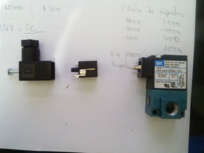

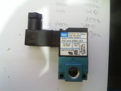

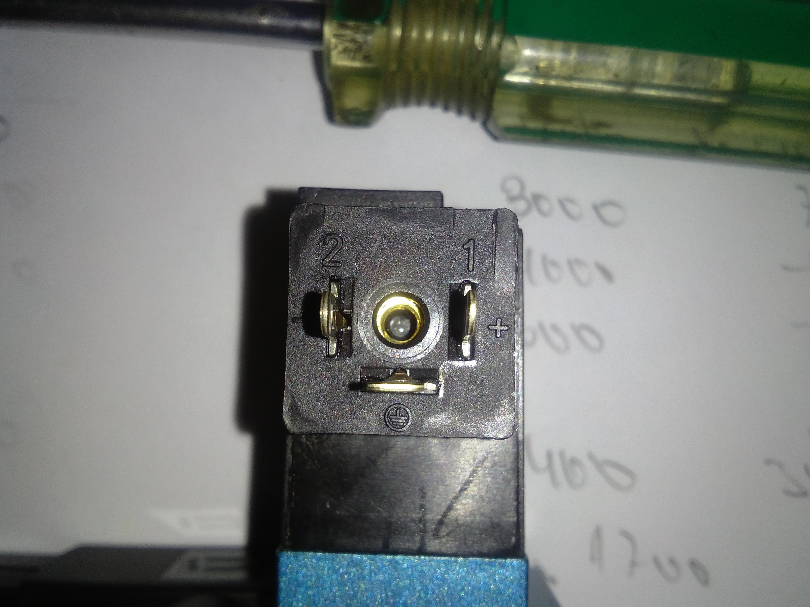

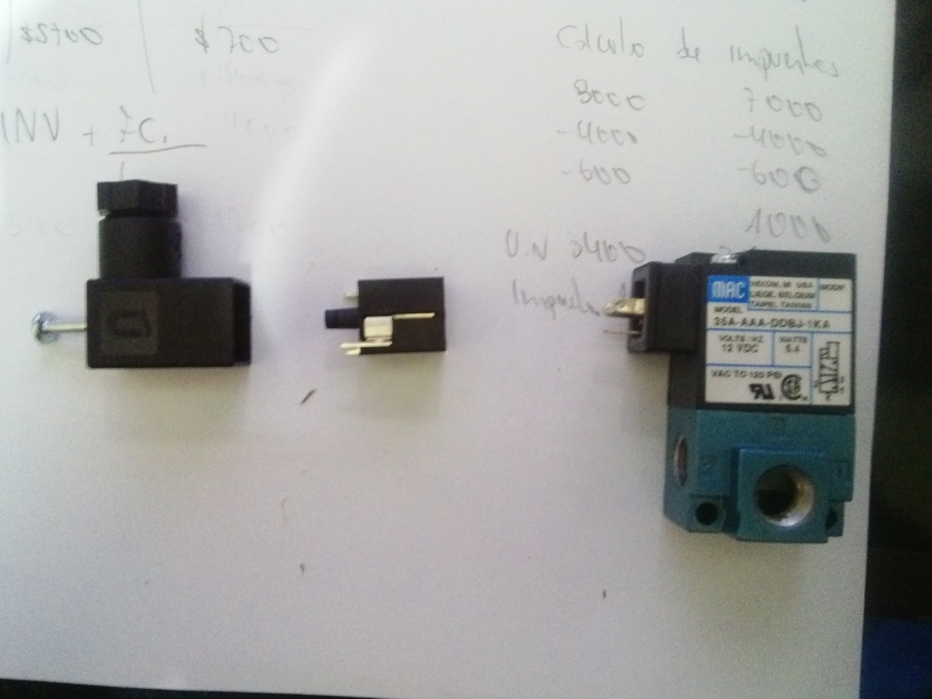

My MAC solenoid is like this, the only difference is that the terminals are there to connect any wire, but there is a "+" terminal, "-" and ground. The connection should be 12v on the "+" terminal and signal on the "-", but should I wire the ground terminal or is not necessary?
pepifebles
Posts:298
Re: what are people using for boost control solenoids?
Post by pepifebles » Wed Jul 08, 2015 8:44 am
You need +12v and aux emu connections
