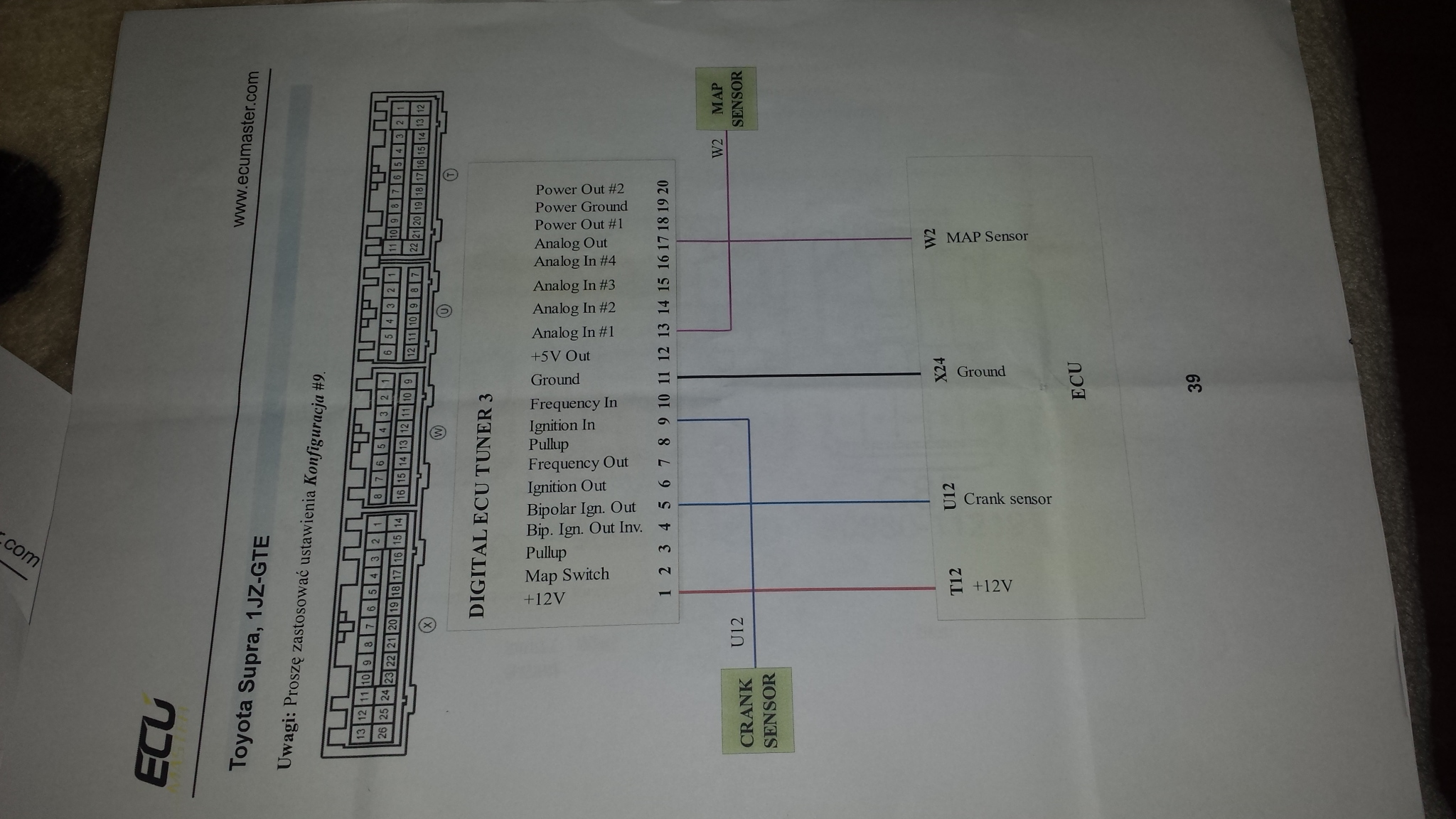

Did anyone wired a DET3 into a Soarer 1jzgte ? I have the pinout diagram of the ECU but this is a first for me and wanted a second opinion on it...
mihaicsv wrote:Sooo, small update ...looks like power,ground,IAT,CLT and TPS are splitted into the factory ECU ,I (supposedly ) figured out how to wire the MAP sensor and the crank sensor in/out of DET3 but I'm still unsure about the injectors wiring in FIT configuration.I found some info from the Megasquirt boys but is for MS2 ,I'll try this because that's all I have at the moment.Originally the injectors in a Soarer are wired in three batches of two (1+4,3+5,2+6) .The MS lads are wiring it 1+3+5 and 2+4+6 at pins 18 and 20 in DET3 with 19 as ground.
I still have to figure out how you wire the injection part using the crank and cam sensors.Crank in is DET3 pin 9 and crank out are pins 4 and 5 but I'm still unclear on how to wire the cam sensor to input TDC signal into DET3 to replicate the 24-1 ignition pattern (crank is a 24 teeth Nippondenso pattern).
Can anyone help with the above ?

Correction to the above ,crank is a 12 teeth wheel ,not 24.
dan_t wrote:Use VR Adaptive 24 Teeth and you'll get a Sync with correct RPM.
