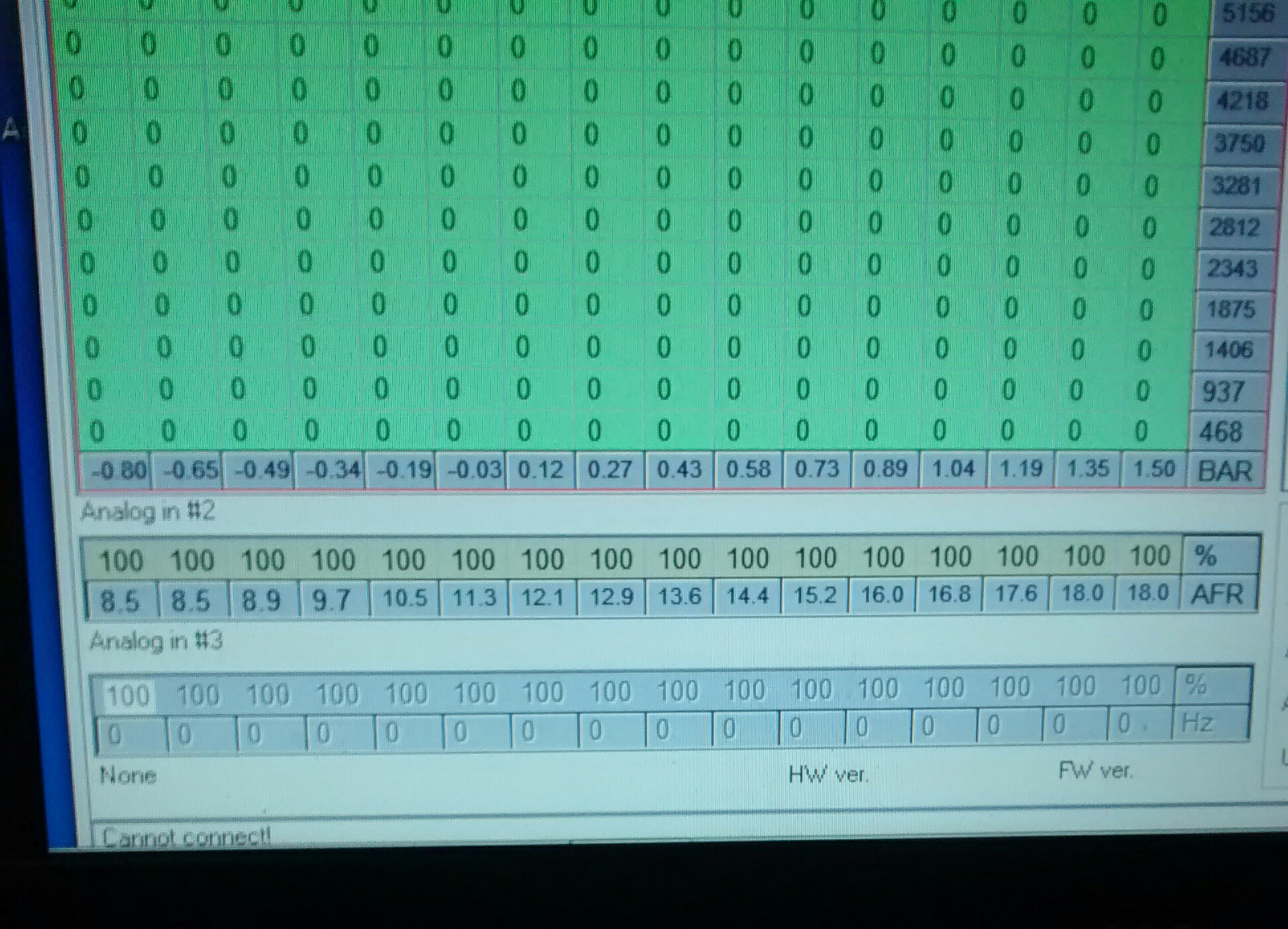

Post by twister814 » Wed Nov 16, 2016 5:08 pm
I have the AEM Fail-Safe scale on analog #3 now. Just Need to check it.

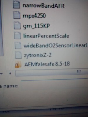

Post by twister814 » Thu Nov 17, 2016 12:11 am
The yellow pad lock must be why it's not working. How do I solve this I been trying so hard. I'm sure it a simple solution. Help

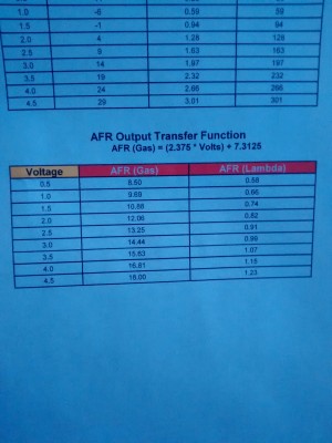

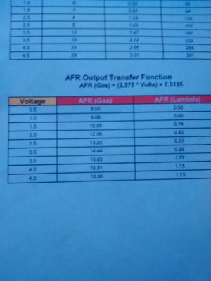

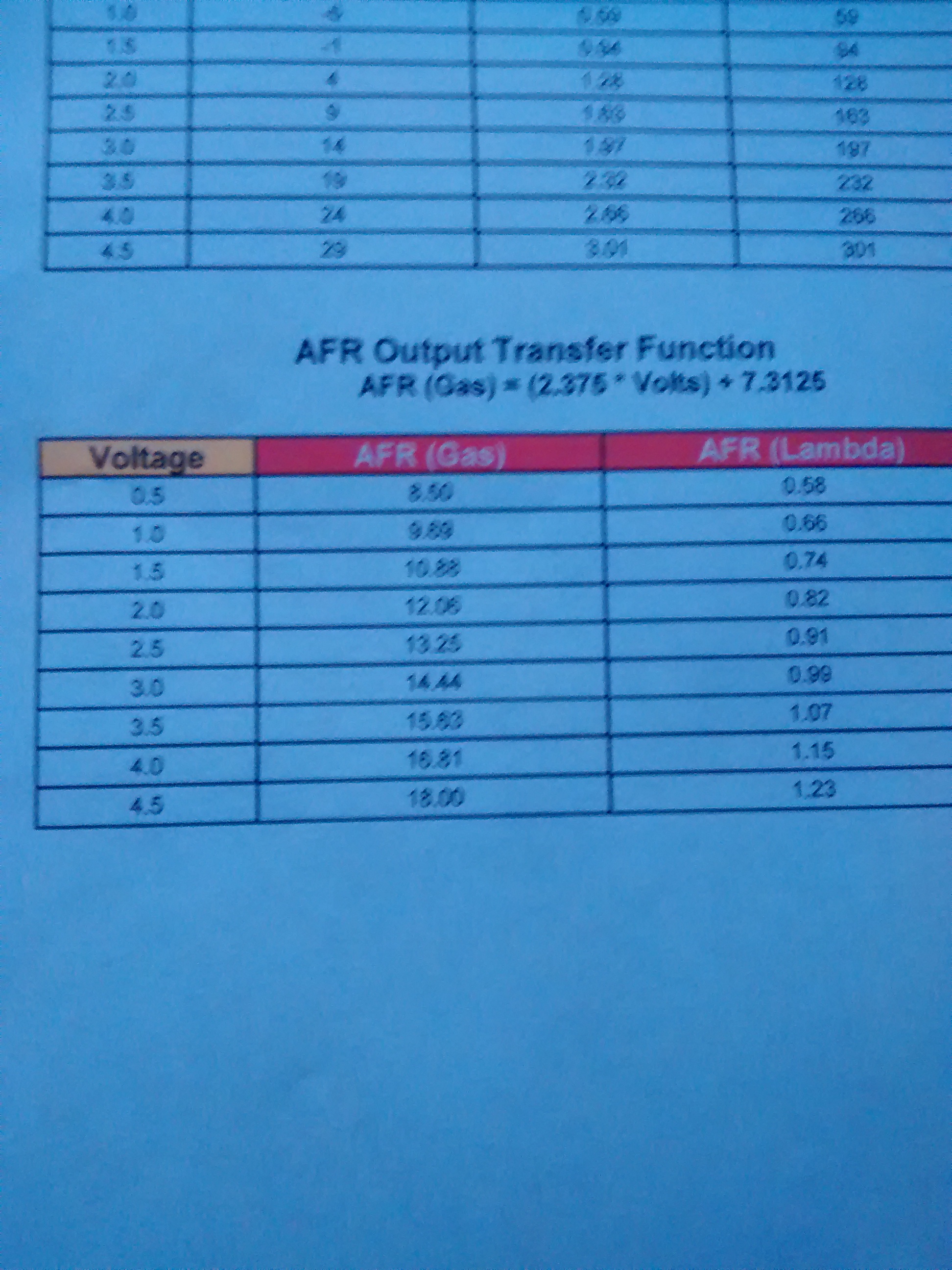

Re: AEM Failsafe Guage Scales Configuration
Post by Doable » Mon Nov 28, 2016 12:07 pm
1. Try pasting the following quote into a text document.
2. Save it as "wideBandO2SensorAEMFailsafe.def".
3. In DET3 --> Setup --> Scales configuration, Load "wideBandO2SensorAEMFailsafe.def".
// scale definition
name = WIDE BAND AEM FAILSAFE AFR 8.5-18
linearize = 0
unit = AFR
minValue = 8.50
maxValue = 18.00
// ilosc miejsc po przecinku
precision = 1
// non linear sensors are defined by equation:
// value = coef5 * v^5 + coef4 * v^4 + coef3 * v^3 + coef2 * v^2 + coef1 * v + coef0
coef0 = 7.3125
coef1 = 2.375
coef2 = 0
coef3 = 0
coef4 = 0
coef5 = 0
