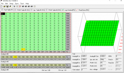

Ok, so I grounded all the analog outputs except for #2 and this is where they all sit at.
Is that supposed to happen?
