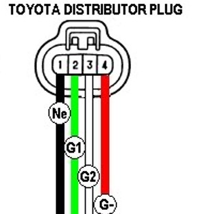

check if your CKP sensor has 3 wires or 2
Michael Osborne
Posts:6
Joined:Mon Oct 24, 2016 9:39 pm
Re: Cranks but wont start
Post by Michael Osborne » Thu Dec 08, 2016 11:28 pm

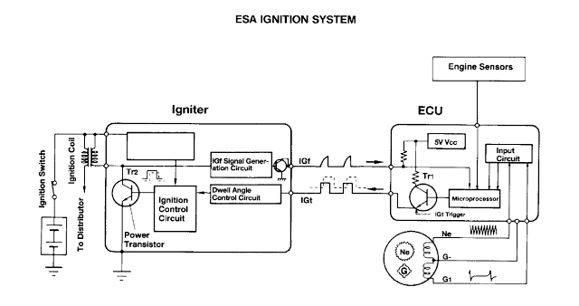

It has 4 wires coming from the distributor (see distributer pic) and there is an IGT off the ecu which sends the signal to the ignitor (esa ignition system). The way which I thought it would work would be to use the IGT wire from the ecu into the det3 then to the ignitor?

Latest update. The car is now running!
The wiring using the IGT wire is correct and doe transmit the signal from the Cam sensor.
To get the signal from the cam sensor I removed the distributer cap and rotor arm, cleaned the 2 pick up points and the trigger wheel. With the distributer cap removed I checked that the pickup points air gap and the resistance of the connections all of which were within tolerance.
I then reconnected the det3 and activated the self test, at which point the ignitor started clicking, turned the engine over and it started. I suspect that the reason it wouldn't start was a weak signal from the cam sensor.
