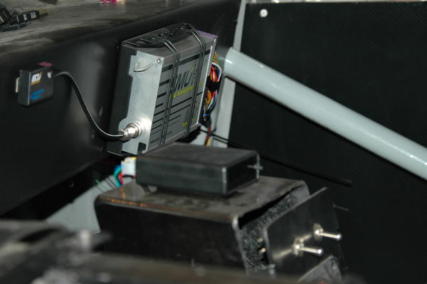

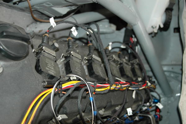

I'm want to introduce to you our project for this winter to share and see what we are able to get. When I say “we” I mean the four people who started the project here and the people of the forum that will help me along this proyect. I will need help for sure, this is our first standalone ECU.
Starting point:
Hillclimb racing BMW E46 with S50B30 completely stock engine, stock ECU (remaped) and wiring, that has being racing with standard fuel.
The project:
- Engine will remain stock for this year
- Remove stock wiring and ECU (allready done) and install EMU (is in garage)
- Remove stock airbox and intake pipes
- Keep infinitely variable intake vanos controled by the EMU
- Redesign and adjust fuel system (injectors, fuel pumps..) to use racing fuel.
- Remove MAF
Ending point:
Dynotest and races results will tell... answer in three four month.
