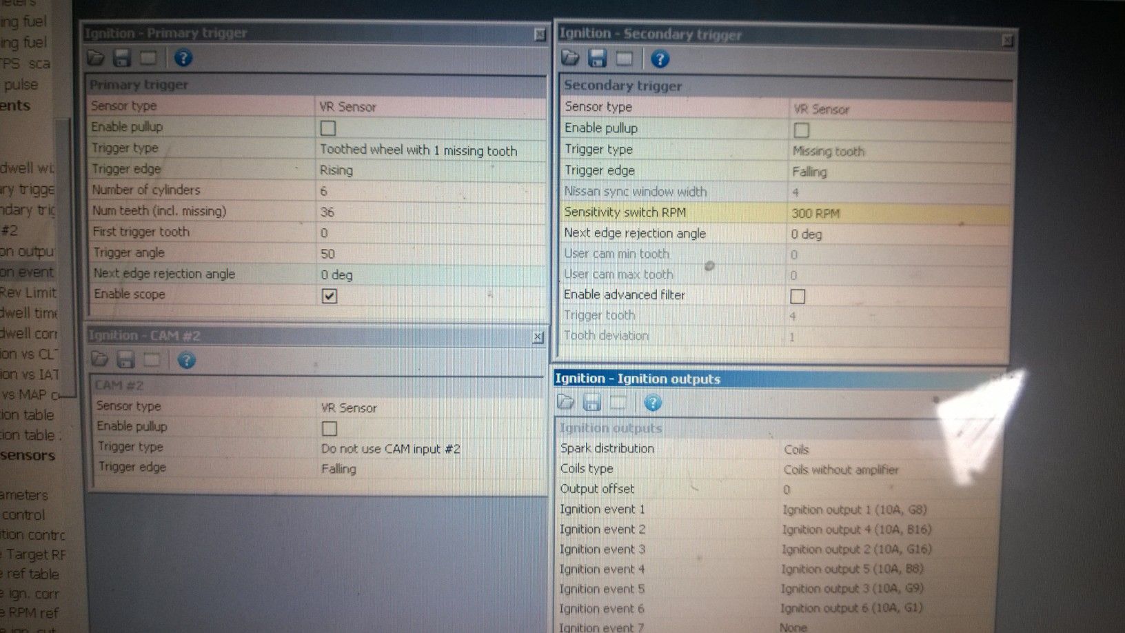

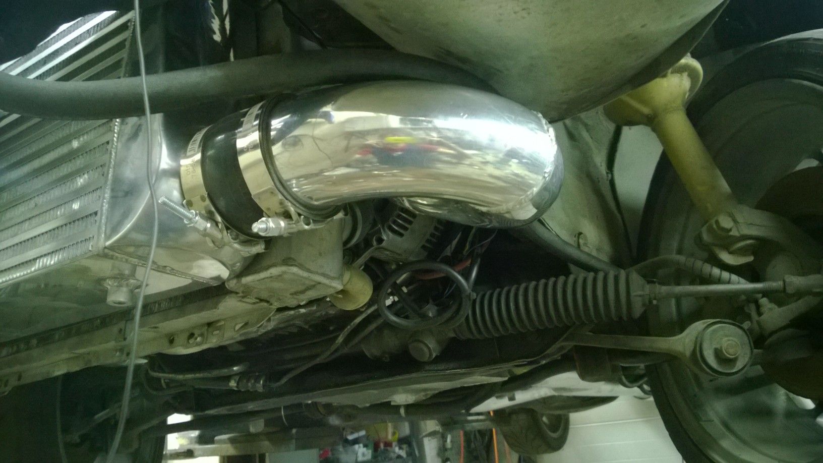

Sierra spec.
Stock 3.5L Ford Edge engine (cyclone-09) with two turbo and intercooler
my custom made intake and exhaust manifolds.
Bmw GS6-53dz gearbox
8.8" IRS Rear diff Ford Racing 3.73 and lock
Trigger set up. (thanks Jakub and teamviewer!)Image

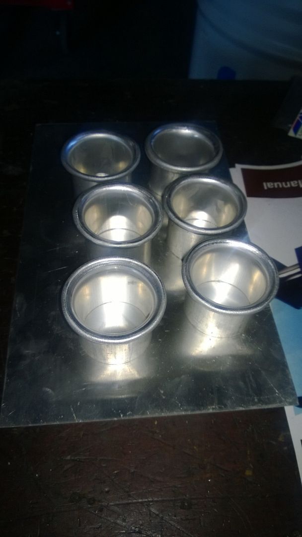

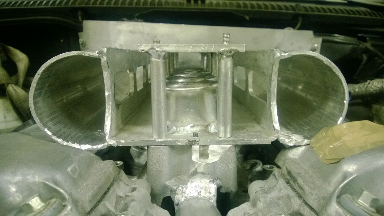

Engine is stock but anything also making.
Intake building pic.
Handmade rear piece
and trumpet

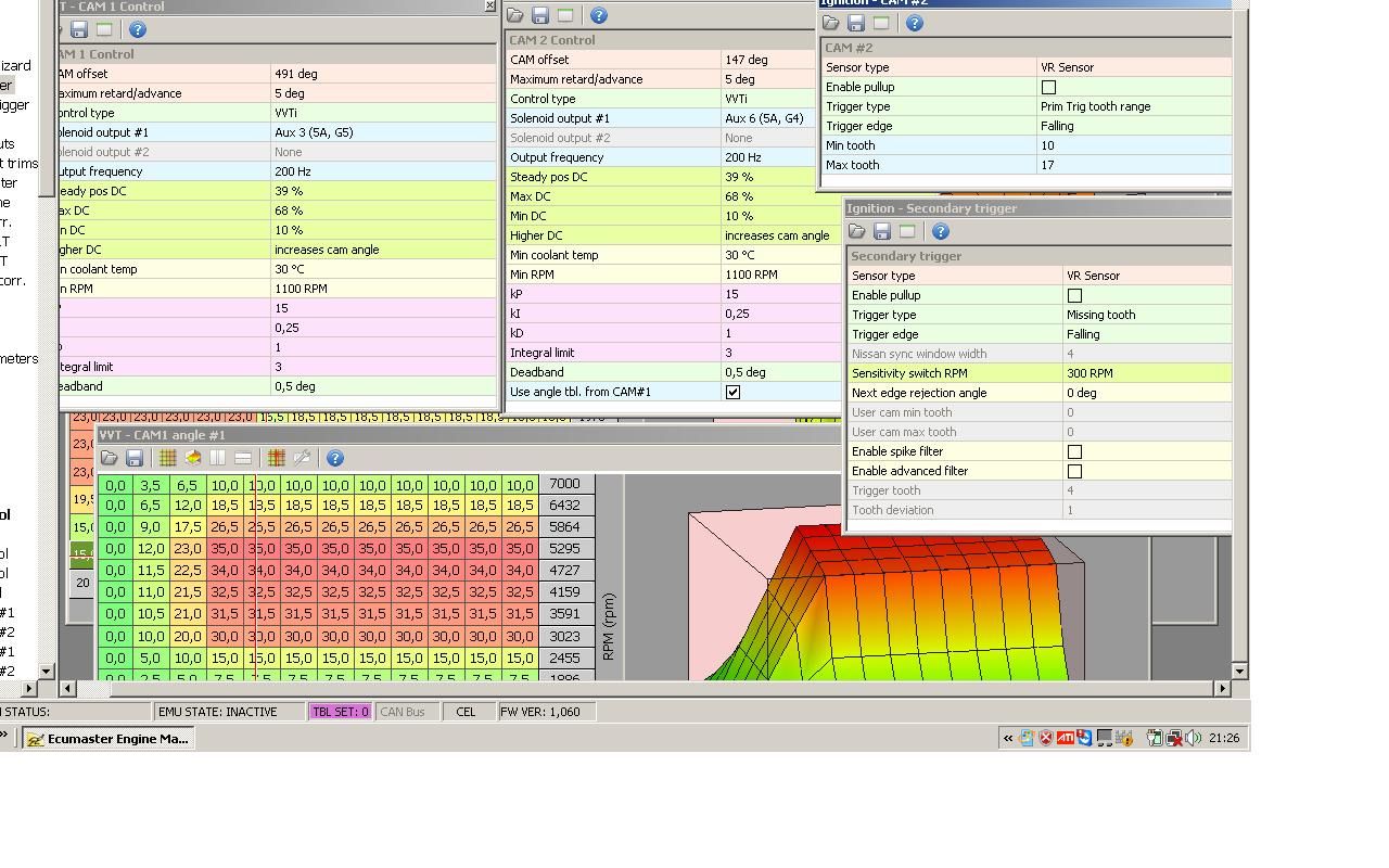

Post by Puuhapete » Fri Sep 12, 2014 8:42 pm
This engine vvt setup grow up today and thanks again this excellent service Mr.Jacub. Very good. It easy living modern times. 8-)
Next, we drive controls the power bench and we get more precise values ​​for these.
