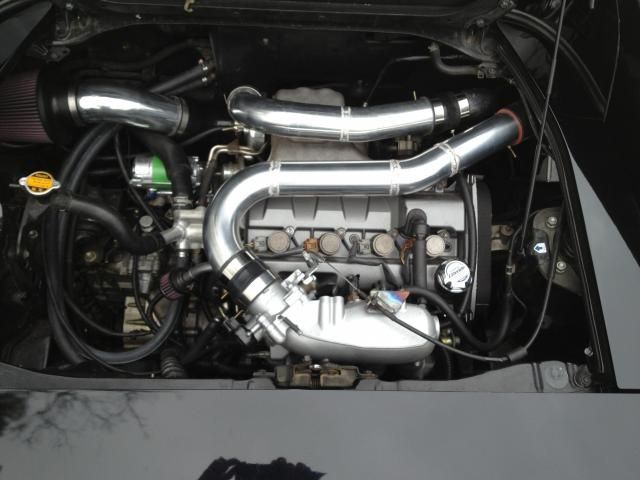

On to the car...

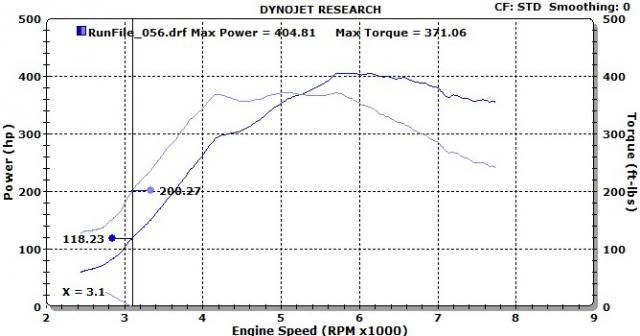

1995 MR2 Gen4 3sgte swap (from Toyota Caldina)
11mm Injector Dynamics 1000cc fuel injectors spraying E85
Walbro 255 fuel pump
Gen3 rods
Wiseco 86mm pistons
ATS Headgasket
ARP Head Studs
ATS valve Springs
Billet compressor upgrade to CT15 (stock gen4) turbo by ATS
Kinugawa Wastegate Actuator 1bar spring
Ogura single-disc clutch (with twin-disc rattle)
And most importantly ECUMaster EMU
Stock everything else.
At 2bar boost it makes 404 at the wheels. Pics to come...
