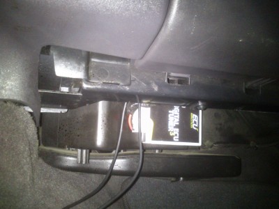

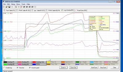

i have used the det3 alter mapsignal and change ignition
oem ecu (jtec) runs engine and transmission/instrumentcluster/charging so going total standalone is not an option

i will say the ecumaster is a lot of bang for the buck and have helped me get this far

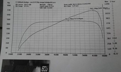

its up and running on Ecumaster ECU . will ad more info as soon as its final dyno session at Psi Motor

Post by Tobbe1 » Sat Oct 01, 2016 6:01 am
at aprox 1bar/14psi
thanks to PSI Motor Sweden ,Per, Mattias
