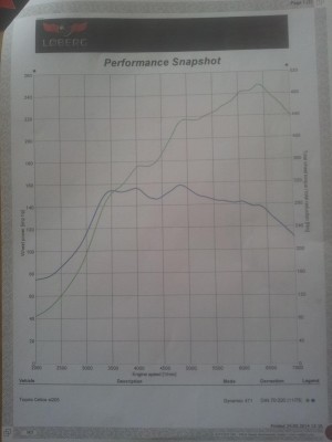

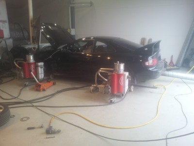

Car at the dyno.
The results are from a pretty conservative dyno.
The actual power gain compared to the stock ecu is HUGE. It feels like the powerband has been widened. From 3krpm it just explodes when the pressure builds, and keeps it going all the way to the redline.

How much boost got in this dyno run? I have bought Ecumaster emu with pnp adapter today. I would like have any advise or information about install or anything.

Post by skogs » Mon Feb 02, 2015 7:04 pm
I ran 16 PSI. More pressure than that didnt yield much more power due to high turbo temp.
pepifebles
Posts:298
Re: Celica ST205 - daily driver
Post by pepifebles » Mon Feb 02, 2015 7:31 pm
skogs wrote:I ran 16 PSI. More pressure than that didnt yield much more power due to high turbo temp.
250 whp could be 320 Engine Hp??
At high rpm has modified ignition map? I'm looking for a dealer who can make me the maps. here no one is around
The fun starts now
Post by PSI-Motor » Mon Feb 02, 2015 7:47 pm
Its not WHP its HHP. Big differens. I would guess 275 at the crank.
pepifebles
Posts:298
Post by pepifebles » Mon Feb 02, 2015 8:47 pm
At 16psi its easy get 270 crank hp without EMS.
The fun starts now
skogs
Posts:46
Joined:Fri Sep 12, 2014 11:24 pm
Post by skogs » Wed Feb 11, 2015 1:00 pm
PSI-Motor wrote:Its not WHP its HHP. Big differens. I would guess 275 at the crank.
What do you mean by HHP?
The dyno shows power measured at the wheels, isnt that the definition of WHP?
Edit: You mean Hub-hp? That should be the same as whp if the dyno is calibrated correctly. I guess you dont want to take the power loss caused by the tires to affect performance numbers on a conventional dyno.
At least on the dyno that was used here, 250hhp = 250 whp. (compared to any other type of dyno)
