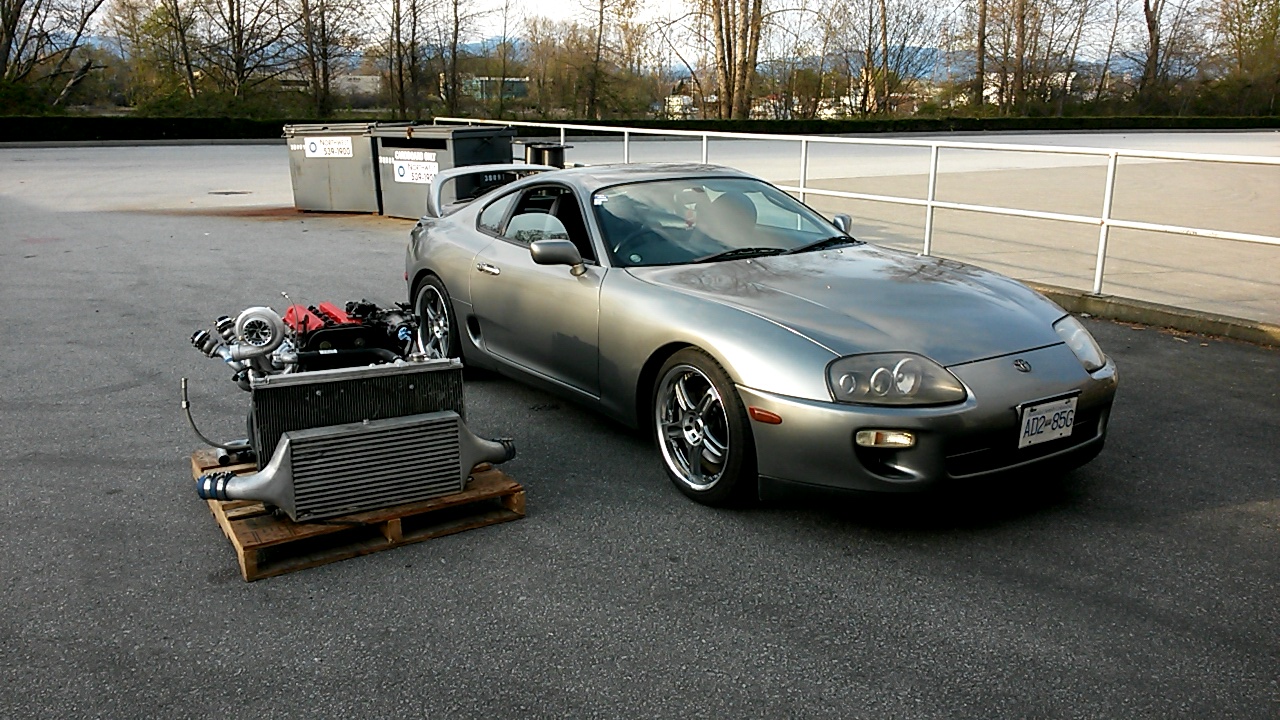

Here is my 96 SZ-R 6 speed . came with a V161 and it was NA
The motor build is
wisco 87mm 10.7:1 pistons
PT 6766 turbo
HKS 264's cams
Brian Crower vales/sprins/retainers
1050cc injector clinic
H beam rods
ARP rods/mains/head studs
chase bays engine harness
and the all mighty EMU unit
Its only a daily driver but i didnt want to have a NA supra . so I pulled my SC400 off the road and rebuilt this motor . hoping for 600 daily
the pics are old the car is running and driving now
