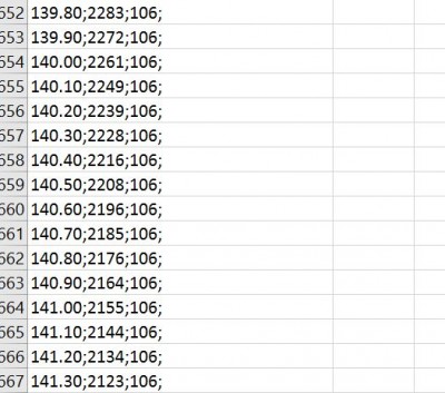

This excel file shows the 0.1 cell change.

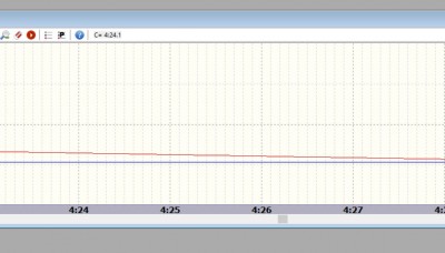

This screen capture shows the graph at 4 minutes and 24 then 25 seconds and so on. The light coloured lines show the divisions in 0.1 of a second.
As you can see from the excel file the time stamp is 0.1 second. I was asking if this could be increased to 0.01 second.
However as you have said the sample rate is 20hz (0.05) then that's the best data shown rate it could be.

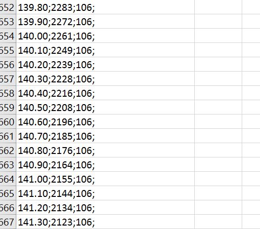

After separating out the Data it's even more clear what I mean.
You can clearly see the time is in 0.1 seconds.
