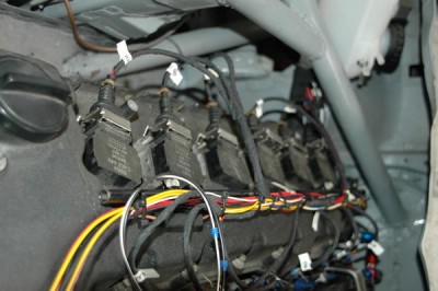

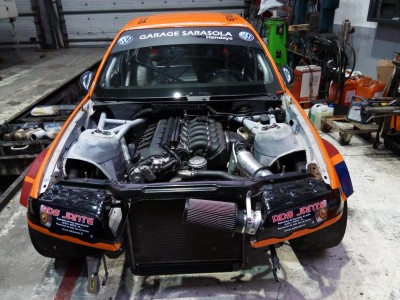

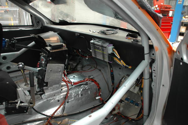

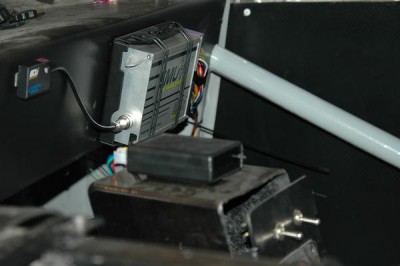

Some photos

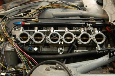

One more

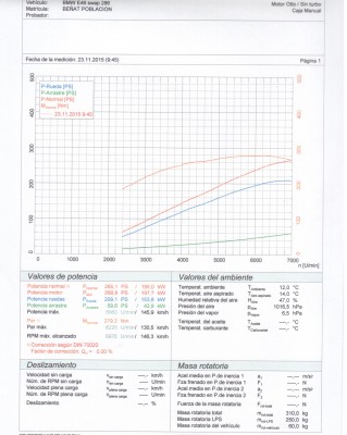

After a lot of work and some problems we got the car ready and racing last week. Still some work to do with the electronic but the car is ready to race. We got a good feeling during the race, first in our category and fourth overall. See classification, the rider Beñat Poblacion: "http://www.fotomotor.es/competicion/1326/clasificacion/" and a video "https://www.youtube.com/watch?v=6Lt2vU8T41U"
I will tell you about the power as soon as we finish with the tuning, but up to the moment we are about 50 hp over.
