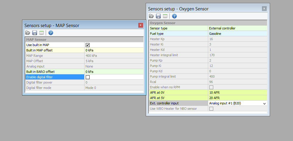

ok I want use emu ecu sensor. Please could you tell me how configure map sensor in emu software?

Re: Celica ST205 Gt Four
config as your pic as posted (uncheck digital filter)
Then something its wrong because I have vacuum hose connected. Its possible that solution to my overfuel is uncheck filter box?Jadzwin wrote:If you need to use EMU 400kPa MAP (we suggest to use it) you need to connect a hose between your intake manifold and EMU. That is the reason your engine is overfuel
