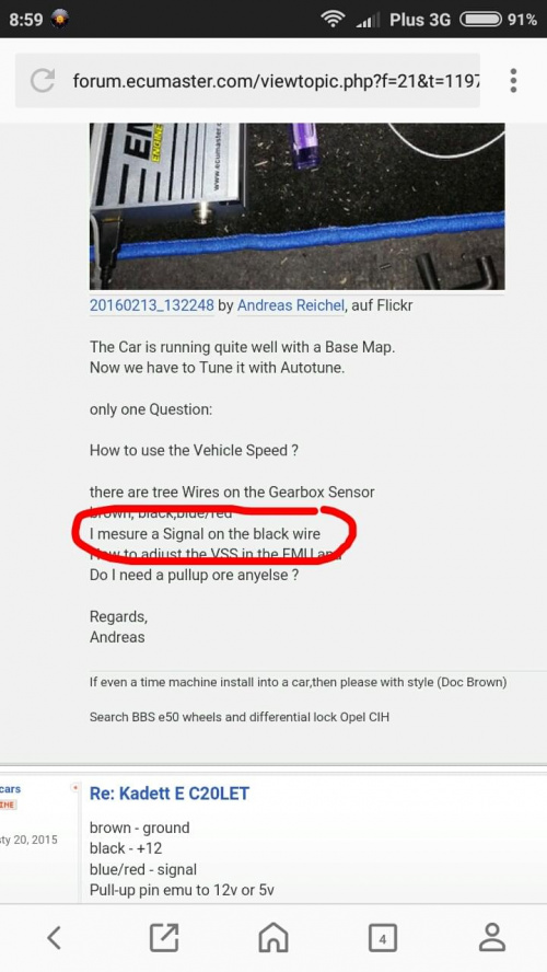

we start running the Kadett Yeasterday for the first Time.
20160213_132248 by Andreas Reichel, auf Flickr
The Car is running quite well with a Base Map.
Now we have to Tune it with Autotune.
only one Question:
How to use the Vehicle Speed ?
there are tree Wires on the Gearbox Sensor
brown, black,blue/red
I mesure a Signal on the black wire
How to adjust the VSS in the EMU and
Do I need a pullup ore anyelse ?

brown - ground
black - +12
blue/red - signal
Pull-up pin emu to 12v or 5v

Now i see problem
SIGNAL ITS ON BLU/RED WIRE :)
