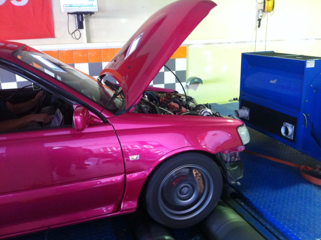

my friend dinos has a Toyota starlet gt turbo ep82
Engine: 4efte ep82
forged pistons wossner std
forged rods
std head gasket
std head bolts (didn't know that when I was turning up the boost!!!)
4 pucks clutch
TRD ignition leads
440cc fuel injectors (impreza light blue)
255 fuel pump
IHI Vf34 (some damage was on the turbine side)
external wastegate 38mm emusa
60mm exhaust single tube at the front bumper
shorted transmission ratios
Ecumaster Det3 400kpa

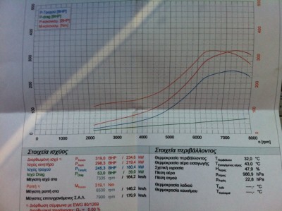

1.5bar 319hp
engine was bought used and we opened the engine to put arp head studs, metallic head gasket, port and polish and we found out that the engine had cr 7.3:1 now we are closing the engine with aprox. cr 7.8 :1 also my friend bought a used very good condition Vf34.
