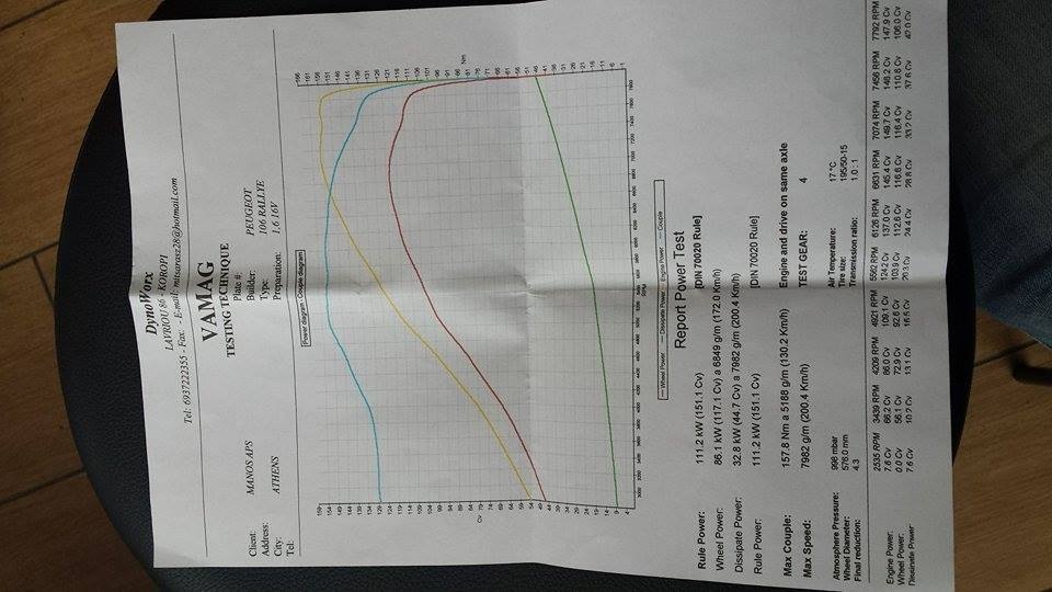

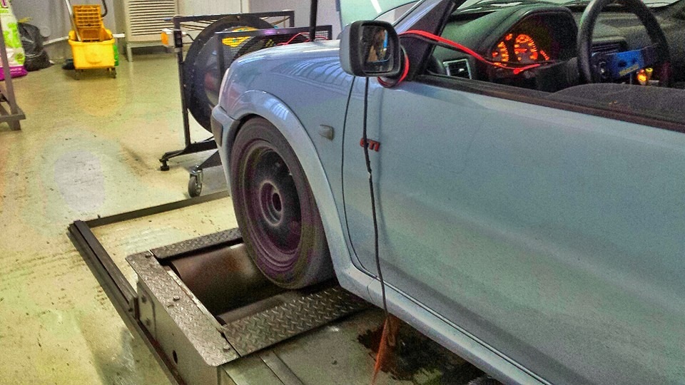

Engine: 1.6l 16v
reprofile cams shafts unknown spec ( bought use 80 euros )
206 metallic head gasket
everything else stock with 180.000km on clock

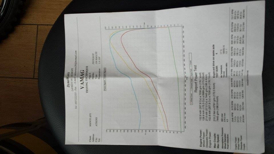

Dry nitrous (told to me that it was 60hp nozzle but it makes more than 60hp
ECUMASTER DET3 400kpa FIT mode
n/a: 151hp
nos: 207hp stock clutch couldn't hold the power and it was slipping on the dyno. dyno owner seed to us that if clutch wasn't slipping we could easy see over 220hp
