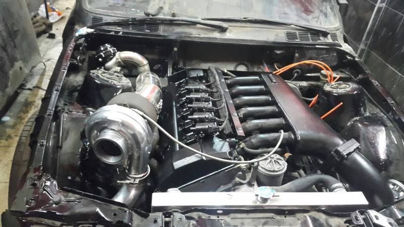

Hi all, Here below the details of my project car, as I have been working it since 3 years, and just started it out, I spent all this time as I changed mostly everything in the car even the cabinet wiring and re-wired my new own harness, below some specs of the car and setup, as this was my chance to install EMU on it and get out the max of it
Project Status: (final Stages).
Location: Amman-Jordan.
Car: BMW E30 1988 4Doors.
Engine: M50B25 NV stroked with forged internals with total displacement ~ 3.1L.
Engine Build: Full engine rebuild with ARP Head/Main, New Bearings, New everything else.
Boost target: 2.5Bar or more as Boost target.
Turbo: Borg Warner hybrid with 72mm inducer
Electrical: Painless Switches Panel / STACK Gauges.
Turbo Accessories: 50mm Tial BOV / 46mm Precision Wastegate / 6-to-1 Exhaust Manifold with 3mm pipes wall thickness.
Fuel: E100 for race / 95 Octane on day drive.
Fuel Delivery: 2x 044 Bosch fuel pumps for e100 Fuel with 2200cc Injectors and high flow AEROMOTIVE FPR / 1x Walbro with 870cc for 95 Octane Fuel.
ECU: EMU with custom made harness.
Trigger System: Stock 60-2 trigger / Cams-Sync -- but till now started on Wasted Spark.
Coils: D858 Coils with Granatelli Coil Near Plug Wire Set.
