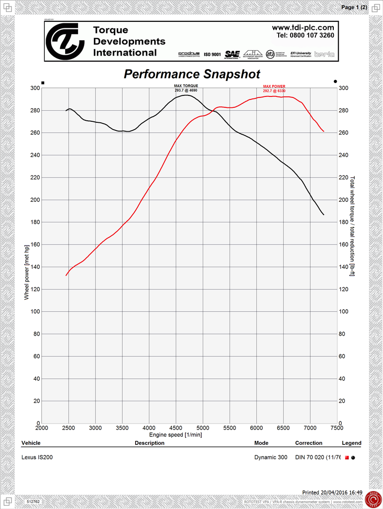

Got it tuned the other day, running 293whp, around 340hp at the engine. vvti is up and runnign and she drives nice.. and bloody fast.

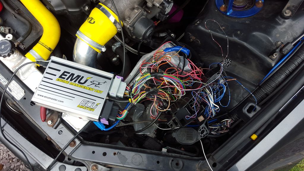

How did you wire up the VVTi module?
Would you mind sharing the wiring? Or did you base it off the JZZ30 wire up shared on this forum elsewhere.

Yea i am happy to share the wiring, well what i have anyway, I used diagrams and information from everywhere. But in the end i wired up the engine from scratch which simplifies everything.
The vvti was wired into aux 5 and 12v i believe, its just an on / off solenoid, i can get pictures if you like?
