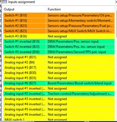

under tools "show assigned inputs" missing CAN INPUTS and the order is wrong

under BOOST BOOST/BLEND SWITCH input missing CAN ANALOGOn the Android Tablet CLT always 0. Analog input1 tells correct value, analog input1 as olpressure tells 0.

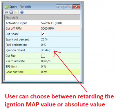

It would be nice to have additional feature/value input for Flat shit. There is only "ignition retard value" for flat shifting (clutch switch activated).
Is it possible to add "absolute ignition value" instead of retard, or best case is to let user choose is it absolute value or retarding value.
Re: Bugs and Feature reqests
It is doable. I add it to to do list.

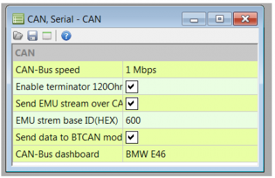

Is it possible to add feature to BMW e46 CAN?
Original fuel consumption meter can be used for boost level. It is 0-20L/km, so it could be e.g. 0-2bar.
How about using the average fuel consumption digital value for showing real time AFR?
